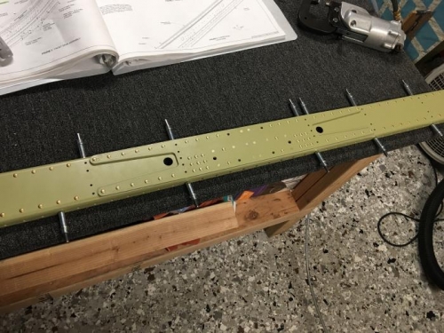

Brief Description:  Rivet front spar assembly
Short session tonight. I clecoed the HS-00913 spar cap reinforcement angles and HS-00907-1 doubler to the front spar. I ran into a little issue with excess primer in the fastener holes so I ran a #30 reamer through the holes.
I was able to use my pneumatic squeezer on all the rivets. No bad rivets, no drill-outs.
A problem free riveting session.
