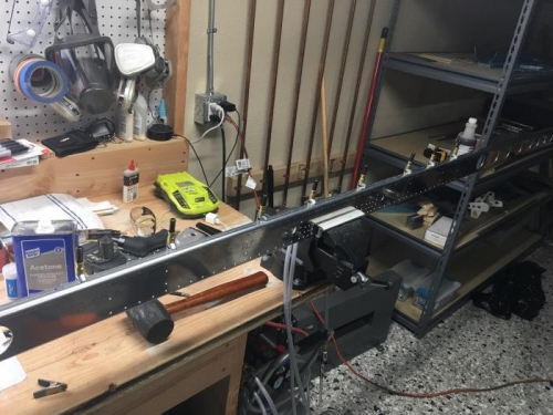

All that was left of deburring the front spar were the ligntening holes. I used a small curved surface file to get out the edge surface roughness and ran a deburring tool around the edge. Tedious work, but the front spar deburring is now finished except for the fastener holes. That gets done after final/match drilling of the double to the spar.

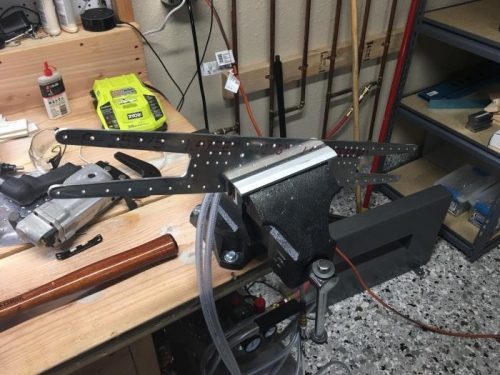

The front spar doubler was also deburred and straightened per section 5. I did a much better job on the straightening of the thick doubler. It's amazing what a little experience does for your productivity and quality of workmanship.

Deburring the front spar.  This is one of the longest single parts on the airplane.
A combination of hand filing, sanding and bench grinding finishes the doubler.
