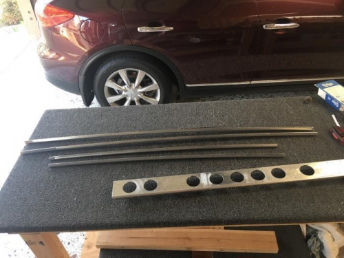

Front spar cap doublers and stringers on top and the rear spar on the bottom.
