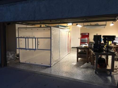

All of that time on my hands and knees really kicked my ass! I woke up this morning to pain everywhere. I was sore in places I didn't even know I had places. I think even my hair hurt!
A hot shower really helped with the soreness enough that I was able to continue. Fortunately, my friend Jay came over to help. I got the other big wall covered before he arrived. This time things went much faster since I'd figured out exactly what to do the day before. It took me less than an hour to finish the other wall.
Once Jay arrived things went much faster. We got the back covered easily, but the front with the cutouts for the fans took some trial and error getting everything to fit. We spent about six hours in total today.
I still need to put on the floor and ceiling pieces and mount the filters and fans, but I can do that by myself next weekend.

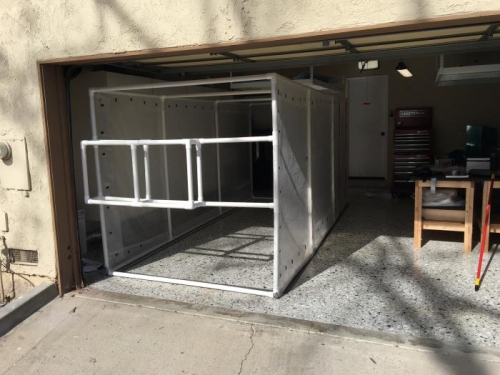

I needed to break everything down so I could park my car in the garage. It couldn't have been easier. I peeled back the sheeting on the front and back, but kept it attached to the left wall. All of the cross-pieces were removed, and the fan mounting structure was pulled out intact. I moved both the large walls off to the side of the garage with the sheeting still attached. All this took about five minutes. All of my planning seemed to be paying dividends.
The two big walls are complete.
The front and back went on without much problem.  It just took longer than expected.
