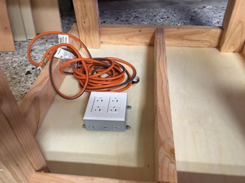

I also put a 2 gang box on the underside of the table and all the tools plug into it. I cut the end off of a 25 ft. extension cord (14 gauge wire, medium duty) and wired it into the gang box. I used a hole saw to cut a 2 in. hole in the top of the table and ran all the tool plugs thru it to the gang box. Now I just have one plug to worry about for all tools.

2-gang outlet box attached to the underside of the table.

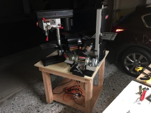

Finished table!
Finished table!
It was after dark when I finished.
