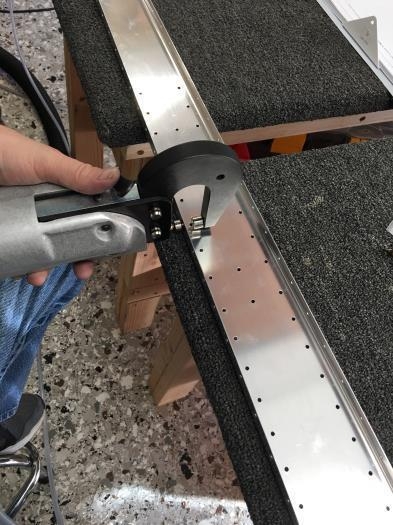

I spent this morning finishing all of the deburring and dimpling of the ribs and spars. This was the first time I got to use my pneumatic squeezer so I played around a bit on some scrap before I started on the parts.
I also got a chance to use my Cleaveland substructure dimples. The difference is that these dimples create a 0.007 in. deeper dimple than the ones for the skin. It gives you a slightly better fit when riveting and almost no discernable gap between the parts.
The only tricky part with the dimpling was getting the forwardmost dimples in the VS-706 tip closeout rib. There is very limited space and the squeezer didn't fit. Fortunately, Cleaveland included a close quarters dimpling tool for this very situation. It's two small dimples pulled with a pop rivet gun using a common nail as a mandrel. The resulting dimple is not quite as good as the standard dimple set creates, but it's good enough.
Dimpling using the pneumatic squeezer.

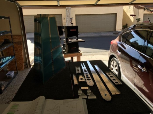

All parts deburred, dimpled and ready for priming prep.
