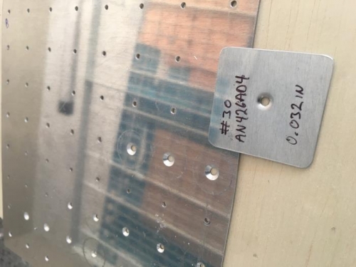

The plans call out for AN426AD4 rivets with dimples in the rear spar and C/S in the doubler. I made a dimpled coupon to figure out the correct size of the C/S. After a lot of trial and error, help from the Vans Air Force web site and a through re-reading of Section 5.5 in the plans I finally got a good fit.
Section 5.5 says C/S until you get a flush fit with a rivet, then go 0.007 in. deeper.That's 7 clicks on my microstop. I tried it and it was a perfect fit!

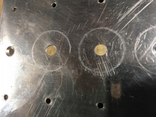

Test dimple coupon and my first countersinked holes.  C/S is way too deep.  Coupon wiggles around.
Hole on the right is C/S for rivet.  On the left is for a dimple.  Difference is 0.007 in. depth.
