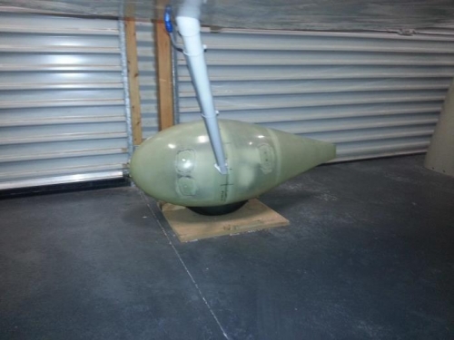

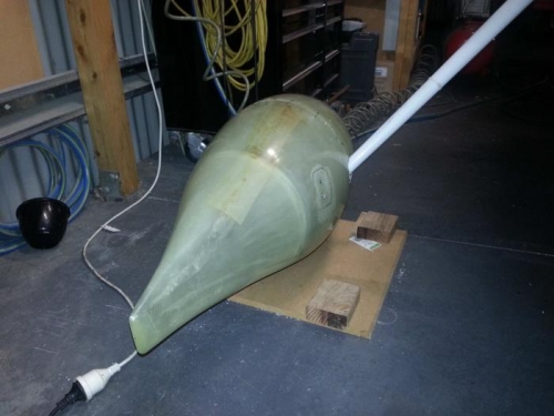

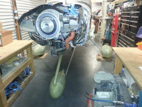

Over the course of the last two weekends I have been struggling (ie very fiddly) with completing the wheel spats.
Getting them to firstly align with the centreline of the aircraft, and then ensure they are aligned with each other.
Stingline.....plumbob....stringline measure.... re-measure....Stingline.....plumbob....stringline measure.... re-measure....Stingline.....plumbob....stringline measure.... re-measure....Stingline.....plumbob....stringline measure.... re-measure....Stingline.....plumbob....stringline measure.... re-measure....
ad nauseum...
I cut the holes maybe a little too big for the leg access, however given they will be covered should be fine. May need to glass them back again, however, not a bigissue.
In the end however, all created and aligned. Now to do the leg fairings and the fairing boots.
All three shoes

Left  :-)
Left :-)
Right spat
Right spat
