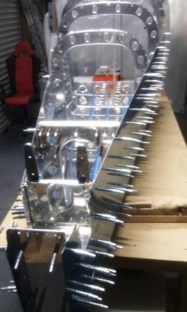

While waiting for the parts for overseas, I started on the tailcone. It has bee a monster effort as the amount of work involved in just the drilling is unbelievable. I am not looking forward to the deburring as multiply the drilling by 4 to get the deburring that is required.
After a suggestion from Peter Pendergaast, I purchased a small electronic screwdriver and a screw attachment for adding the countersink to it for electronic deburring. I tired this out and it can be excellent for the aluminium that is both deep and of a softer type, otherwise I prefer the manual deburring tool.
There was a lot of effort required for the heavy fluting of the turtledeck of the tail cone.
PLEASE NOTE: Heavy fluting means just that; really heavy fluting. It looks like too much, but it is really required to line up the holes. I had to pull the top decks off twice and reflute to do it heavy enough.
Only the top to go
Only the top to go

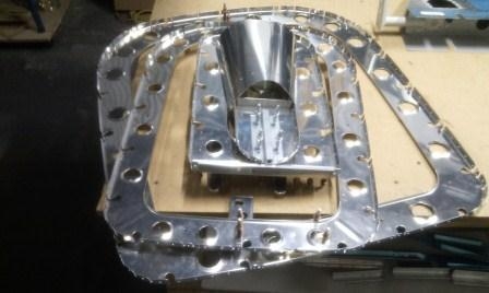

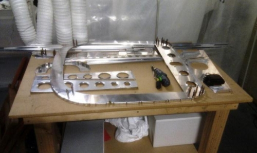

Parts separation
Parts separation
Some parts deburred ready for paint
