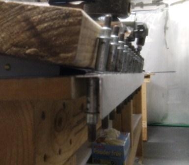

I designed a new tool which I found 'incredible' for applying the tank sealant to the trailing edges and foam wedges.
NEW TOOL: Use some medium gauge fencing wire and bend into a loop. with some length allowing you to easily stir the tank sealant. Use the loop end to apply the tank sealant to the edges. If layed so the loop lays flat on the surface it can go around the dimples both sides easily.
I also used some alumimium angle to set the trailing edge again as I did with the rudder. It worked very well and helped square the elevator as it at first glance had a slight twist (i.e. ~1 - 2 mm over the length).

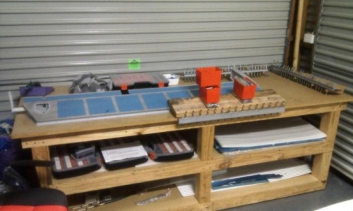

Elevators and trim tabs

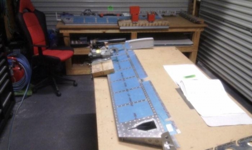

Left elevator and trim tabs
Nice straight edges
Nice straight edges
