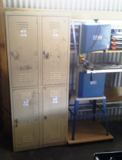

As I wait for primer information and product, I have been steadily improving my workshop. I have changed the layout for my general grinding and hacking workbench, added new storage (i.e. thanks Gess) and made my bandsaw mobile via a castor wheel base. This will help workspace management out quite a bit.

Additional storage and flexibility
