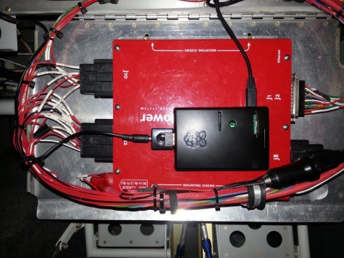

Brief Description:  Rapberry Pi for ADSB
over the course of the last week I have been steadily getting together an ADS-B receiver created using a Rapberry Pi and some Linux software for use with both the AFS units and the iPad and AvPlan.
It works realy cool on the iPad and I am discussing with AFS for input to the AFS5600 so that it displays ADS-B aircraft realtime on the efis.... PRETTY COOL.
Ready to transfer ADS-B to AFS and iPad
