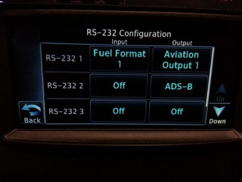

Today Paul and I set about correcting the ADS-B out issue assoiated with the GTN650 to the AFS/Dynon/Trig transponder.
In essence the original wiring diagram from Approach Stack was not quite correct. It mapped the GTN650 into the transponder using Aviation 1 protocol. Given this was done a while ago, and it wasn't fully available no biggy, however we needed to "remap" the wiring and port it to the RS232 Out 2 on the GTN650.
Once this was complete, Iset about completing a flight. The setting on the Garmin initially set at ADS-B+, howevere after a restart on the ADS-B setting BINGO!!!! as Paul said, it appeared.

GTN650 RS232 settings

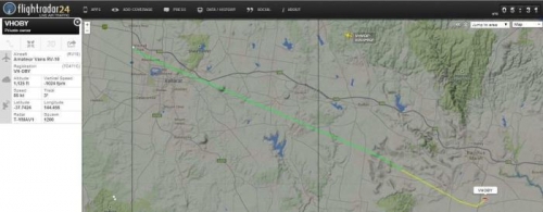

ADS-B paint on FlightRadar24
