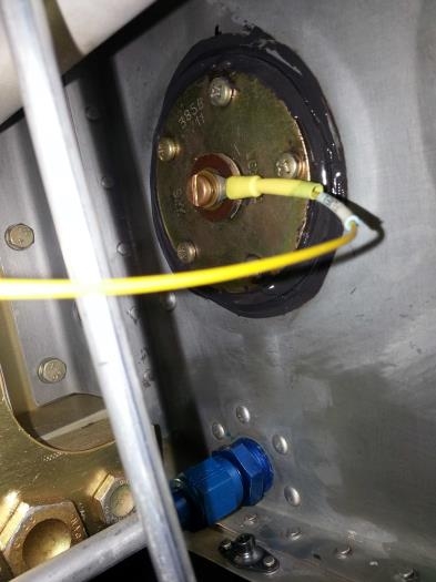

Brief Description:  Left sender unit
Tonight I resealed the Left hand fuel sender unit into the tank. The rubber grommets that I used were not sealing the units correctly. As such I have decided to re-install them with Tank sealant.
This will take a little time to set. I am allowing 2 days before I transfer fuel and re-do the right hand unit.
Here is a copy of the right one using the same technique.
Tank sealant works.
Tank sealant works.
