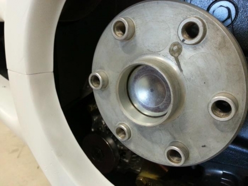

For those who have done this before it is quite an excercise. I needed to remove the "plug" from the mounting hub before fitting the prop.
After a quick call to Mick (i.e. Haynes), I remoived the plug, cleaned the area and fit the prop. 2 turns on each nut at a time for about 15 minutes..... What a pain.

Plug requiring removal

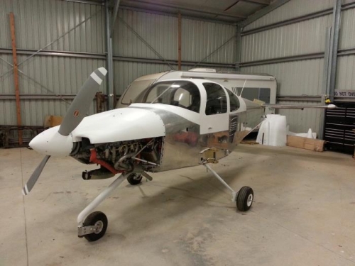

Looks pretty with the prop on.
