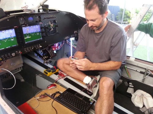

Paul came across today and bought his laptop.
We diagnosed that the issues we were having with the servo's was that the controller software was written for managing analog servo's and that the digital servos act slightly differently.
This causes them to have a "hunting" issue and make quite a bit of noise.
UPDATE: Paul has received an updated piece of code that should correct the hunting issue and I have purchased some analog servo's should they be needed. We will be testing the board with the existing servos foirst as they have Ti gears. If this does not work, we will revert back to the analog servos.

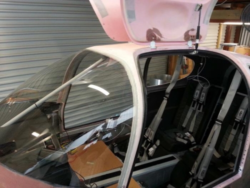

Dad and I worked on preparing the fiberglass for a preventative spray bog coat. It is designed not to be the final finish of the fiberglass pieces, just to protect from UV during the flyoff period and the time flying before final paint.
What's going on with these servo's?
Plastic off, front
Plastic off, front
