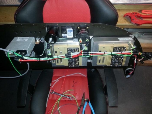

Number of Hours:  6.00
Brief Description:  Re-plumbed the Instruments
Tonight I got my new instruments, plus some other stuff, from the states to satisfy CASA's hardline on TSO'd gear for Airspeed, Altimeter, Compass and AH.
This is even thought I now have 4 different sources for each!!!!! All verifiable via TSO'd GPS....
I DON'T UNDERSTAND!!!!!!
Anyhow, I installed them into the panel and improved the plumbing in the process, refer picture 1.
Once installed into the panel I re-mounted the panel and sat back and admired my work..... Upon a short period of time I packed up for the evening.

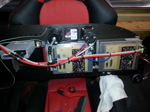

I had a quick look at the wings in preparation for any other parts I needed to address and noticed that the plumbing I had just finished off was fatally flawed.....
See if you can spot the differences between image 1 and image 2.....
Thats right, the static needed to go one side of the panel and the pitot the other side. Needless to say I could not let that go and finished "re-re-plumbing" the panel in the wee hours of the morning.
Updated plumbing.....but wait...
That's better...
That's better...
