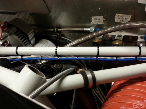

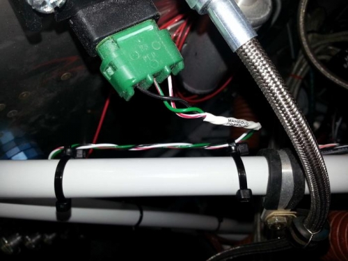

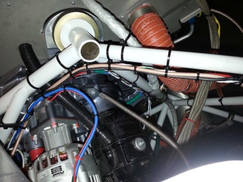

I was out with Andrew and Dan a day before thier CofA and Mike, thier experienced old LAME has some tricks up his sleeeve. The one that was of great benefit was the use of wire ties and how to stand the wires off the engine mount.
Basically form one loop around the frame and wires, and another between the wiring and the mount. This then forms a standoff for the wiring preventing any rubbing of the wire on the mount. Very nice.
Needless to say I re-did all of the mounting wire ties. Looks much more practical now.
