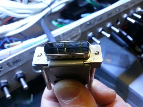

Over the course of the last few weeks I have been completing some testing of the avionics including installing and uninstalling the dash.
As such I have had some issues with connections to the AFS units from the Garmin.
Upon inspection we realised that the pins used in the connector were actually standard pins, not high definition pins. We then re-pinned them and the result is as expected: they work correctly.
New HD pins
New HD pins
