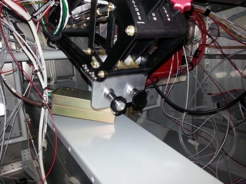

I received the fuel purge valve cable during the week and I was itching to get it installed. Firstly however, I needed to make up a bracket for the cables.
As such I also needed to attach the "carb heat" cable to the same bracket. I was very happy with the setup that I decided on as it sits just below the throttle quadrant and I have decided on the fuel purge valve knob to site directly below the throttle and the intake heat to be under the mixture control.
To me this made perfect sense in a problem solving excercise. I have mounted the alternate air on the dash and thinking about this, I could have swapped the Alternate Air and the "Carb Heat" cables.
I will assess this later after some flyoff time.
Bracket and cable
Bracket and cable

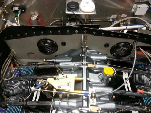

Developed mount and attachment
