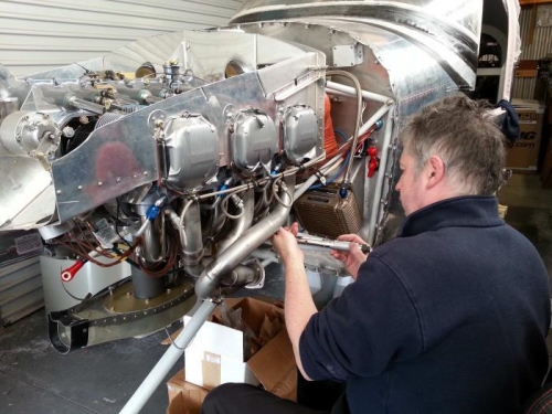

While Paul continued with the electrics, Dad and I focused on the exhaust. It is a beautiful system and was a pleasure installing.
Therewere a couple of thngs that need some review and thought, however I feel that they are more about my approach than the system.
I torqued all of the nuts up to engine spec, however, noticed that the plans ask for a tighter setting. I will go with the engine manufacturers settings for now and if light, will adjust during fly-off hours.
Torquing up the Exhaust bolts

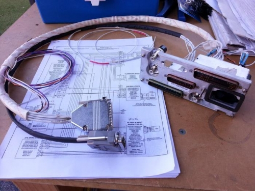

Garmin GTN 650 loom
Garmin GTN 650 loom
Exhaust on.
Exhaust on.
