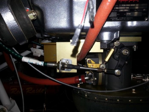

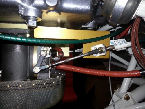

During today I made up the brackets for the Throttle and Mixture cables. These brackets I riveted to the under engine mounting plates.
I am notsure of this as a number of other sites that have done this used bolts. I can very easily add bolts to the brackets with little effect. I will look online and take some direction on this over the remainder of the build.

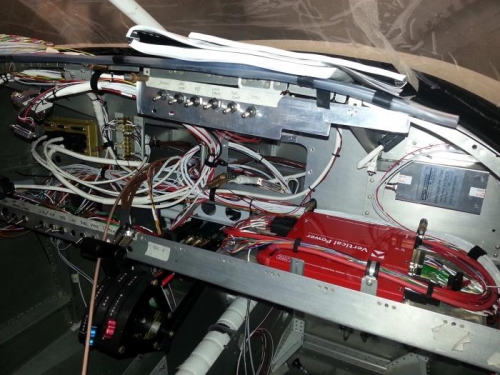

Paul has been steadily adding single wire by single wire and the VPX is virtually complete.
Some additional wires havebeen identified along the way and we are close to cleaning up the wiring over the next few months.

Mixture cable
Mixture cable
Throttle Cable
Throttle Cable
VPX wiring complete, cleanup begun
