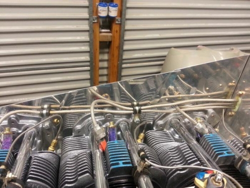

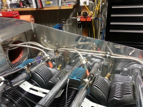

Tonight I finished off the mounting of the ignition leads that are contained within the baffle area.
I was not happy that they were hanging loose and decided to get some extended bolts, lock washers and metal lock nuts and secure them using Adel clamps.
Given the need to have the clamps extend upwards from the head, I made a few from aluminium and used some old Adel clamp rubbers. They worked out well andnow the leads are secured.
I am a lot happier that this is the case and will complete the process nearing completion with zip ties to finish off the job.
Paul's ongoing work from Sunday
Right side now secured
Left side also secured.
