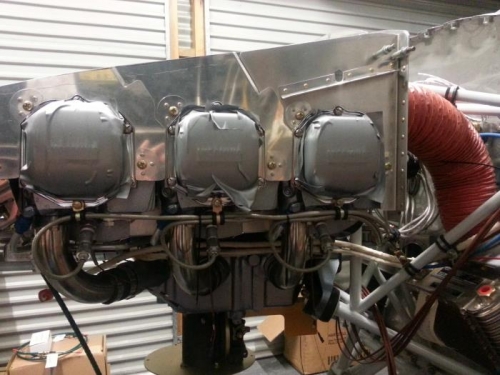

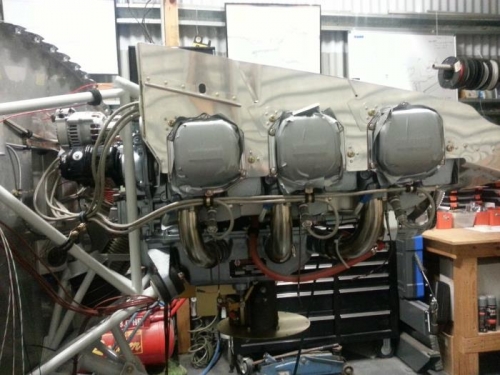

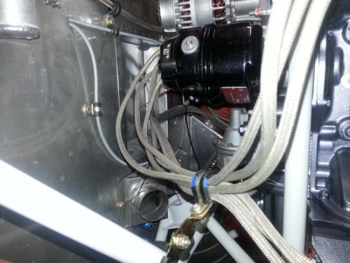

Today Dad and I began laying out the ignition wiring to the spark plug points. It was very interesting to get the right amount of slack in the system and still have it mounted securely.
I definitely think I will revisit this,however at the moment I am happy that they are mounted safely awaiting final zip tieing.
Paul also continued on with the Avionics inside the aircraft and the photo will appear on the next post.
What I did recognise was that the top leads were not secured within the baffled area. I did not like this so went to Keables and got some bolts that were longer than normal. Solution on next post.
Right side of engine
Left side of engine
Left side of engine
Still to be finally zip tied
