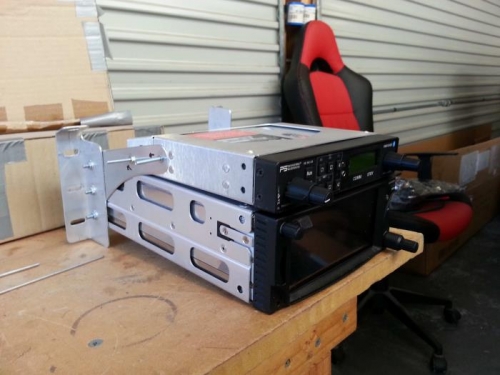

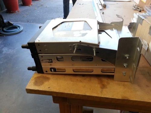

Today we worked through aligning the PAR100EX and the Garmin GTN650 into the front panel and into thier respective cages.
Once this was complete the need to align and attach each of the cages together so that they would be joined correctly ready for the final drill holes in the front mounting flanges.
It took quite a bit of 'fiddling' to get right,however, very happy with the depth, the mounting and the ability to get each of these unitsboth in and out of the panel.
Cages mounted
Cages mounted
Fronts of panels align
