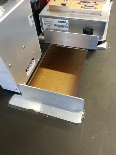

I spent Saturday trying to work out and create some mounts for the Garmin GTN650 and the PAR100EX.
I originally was going to creat the mounts that connected to the lower cross bar and the screw mounts for the panel. However, when trying to fit the panel for some testing it was obvious that this was a bad idea as the pitot and static lines would cause mounting problems.
So I decided to bond the mounts to the panel itself. this looks like it will work well.

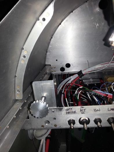

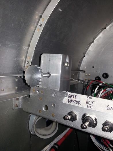

Sunday Dad and I worked on mounting the rudder trim control. This actually took quite a bit of time to decide on the location, mounting approach and the bulkhead through holes. I finally got it mounted and used a double flush rivet technique to be able to mount the trim unit.
Pretty happy with the outcome. When we come to final panel mount we may need to open the holes a fraction, however, they look quite good at the moment.
Garmin GTN650 and PAR100EX front mount
Rudder Trim System
Rudder Trim System
Bulkhead through holes and trim
