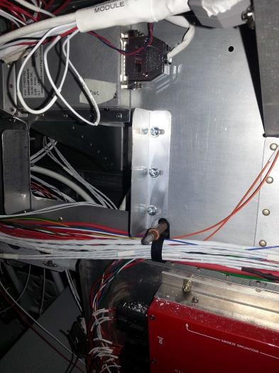

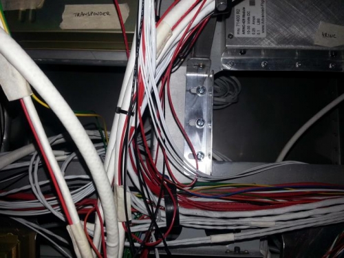

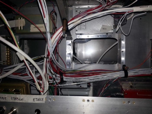

I have re-installed the rear GPS brackets.
The main reason was that the rear brackets were not deep enough for the mounting of the tray. And given I needed to complete this re-mount I decided to also alllow for some lateral movement.
This will allow a better mounting of the rear of the GPS mounting tray.
I used rivnuts to set the bolts. This made the process very easy. I slotted the newly made brackets so that this would allow for the lateral movement.
Rear right GPS cage mount
Left bracket
Left bracket
Final bracket mounting.
