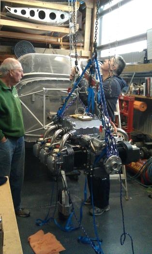

Today, I decided to load up the engine with Anti-rust oil and rotate the engine to ensure that the Cam has been lubricated and ensure that no detriment to the engines internals can occur while I complete the rest of the assembly over the next 6 months to first flight.
This needless to say took quite a bit of management. In the end with ropes and pulleys, this was achieved sucessfully and a series of dessicant plugs and bags repositioned to ensure a water free internal environment at least up until the running of the engine for its first time.
What sort of hat is that.....

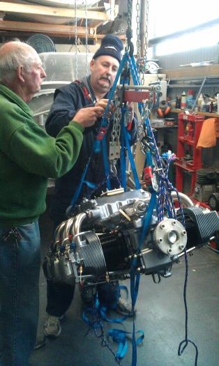

Inverted and oil up to the cam

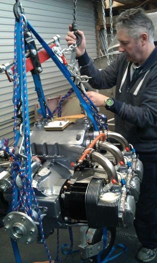

Ready to flip back over
