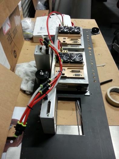

Today I received almost al of the parts for the assembly of the static system. There were some parts missing, however, they are being sent post paid in a few days so no problems.

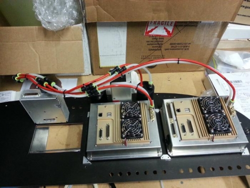

I got to work to arrange the pitot and static components into the instruments and then cut the tubing to fit. I think that it is looking, OK, however the tube is very stiff and may need some 'persuasion' to sit comfortably.
The only one I am having trouble with is the Altimeter as it has a push on fitting and as such with the tubing is hard to fit. I may need to try another option for this combining hard and soft tube.
A little experimenting will be required here.
Static and pitot systems
Another view
Another view
