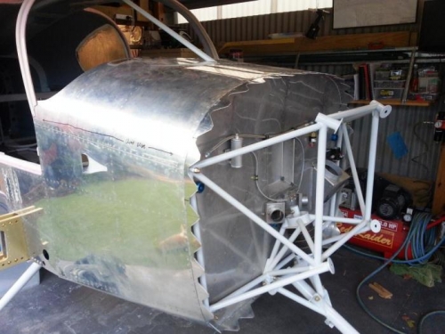

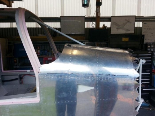

Another good day of work. I have now committed the Upper Cowl to the fuse. It is fully attached and all work relating to this upper section will now need to be completed from within the aircraft.
As part of that attachement is the Milspec fasteners tabs which are now attached. This will allow me to mount the engine and cowl and address the full fitment of the cowl to the firewall.
I also attached the NACA vents on both sides as well as the heater servo system ready for the connection to the heater cables.
Upper fuse attached.
