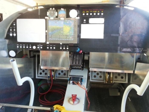

Today I made up two trays that drop down under the Avionics panel to support the Approach Fast Stack Avionics Hub and also to support the VP-X Pro.
The hub will be on the left behind the AFS units and the VP-X Pro on the right.
UPDATE: Since changed the layout of the switch gear late in the process I have since noticed tha the left panel will need to shift slightly to the left to ensure the Alt Air pull cable is clear of the hub.

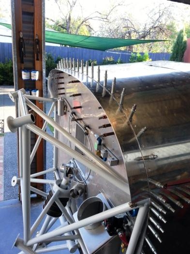

I also commenced work on the cowl strips that will be used to attach the cowl to the firewall.
Left and right trays
cowl strips: the beginning!!
