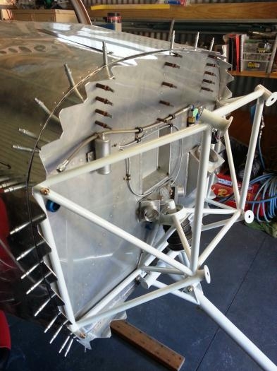

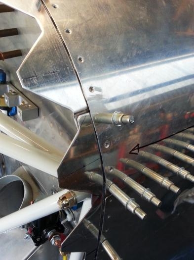

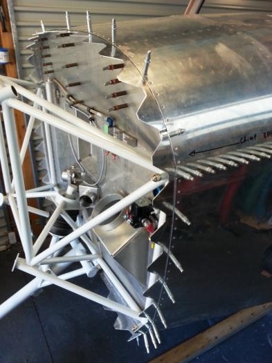

Today I spent a lot of time measuring and cutting and adjusting the tabs associated with the Milspec fasteners that I am using to mount my cowl to the firewall.
Now the interesting part of this is that I need to mount the upper front section of the Fuselage before I can rivet the fasteners tabs to the firewall.
And then I can't actually fit the fasteners until I have the engine on and the spinner in place. Once this is complete, I can then fully fit the cowl and the cowl fasteners.
