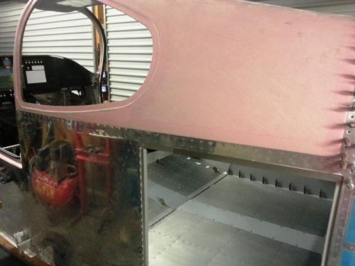

Over the course of the last two days, I Dad, Paul and I have been working on the cabin top final attachment to the fuselage.
Saturday I realised that I actually drilled a #40 hole instead of the #40 hole for the pop rivets. As such I needed to redrill, re-dimple and recoutersink all of the holes.
Now of course I could have pounded some rivets into the structure instead of doing all of tht, however, I was unsure of the reason we were using pop rivets in this loation rather than the standard rivets. So I made the change.
It took probably 3 hours to make the change, however, I was happier knowing I went with the plans.
Today we completed the final fitment. All of the sides are pop riveted and the bolts are in, torqued and marked. No going back now.
Pop riveted on...
Pop riveted on...

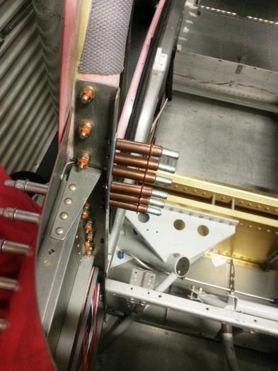

Bolts torq checked and marked

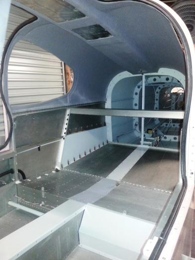

Looking like a plane  ;-)
