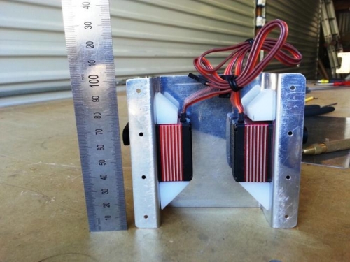

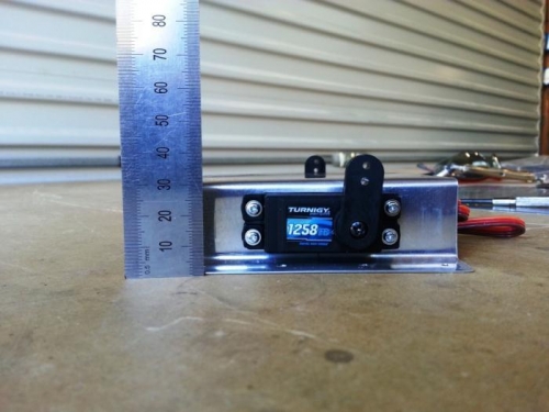

Today I created a servo mounting to control the heat inputs for the cabin. This way I can have the passengers in the rear controling thier own heat.
Servo's are Turnigy and can push/pull 14kg/inch. This is more than the Ray Allen servos and cost only $35 each.
I tested the push/pull cable and it will only require 2kg of force.
It will go under the side panel near the front passsengers legs.
