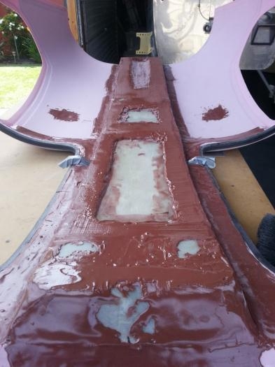

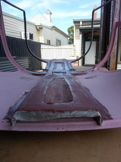

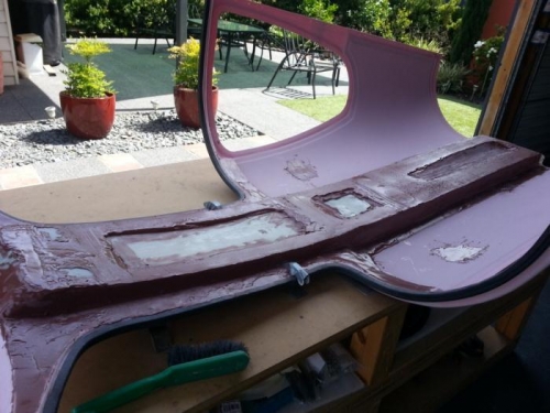

Overhead Console - Forming
The overhead console is not secured to the canope, and therefore it was time to "goop" it up ready for final forming.
Epoxy resin in approx a 1:5 ration of Microballoons. Good paste and easily spreadable. Ready for a sand back and the process begins.
Gooped up
Smoothed goop
Looks OK from here..... :-)
