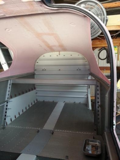

Brief Description:  Passenger seats down, rear seatbelt passthrough in

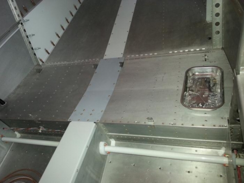

This evening I spent alot of time just riveting down the rear passenger seat flooring. It too quite a while and during the first few rivets I noticed that this section of the quickbuild had not been fully completed.
I needed to match-drill every hole and then debur to allow me to complete this part of the build. Needless to say, this took quite a bit of time, however, once complete; it looked good.

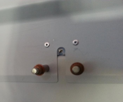

I also riveted the Rear seatbelt bulkhead passthough supports into place. This was fairly quick as Paul had made the pieces up the previous weekend.
Passenger seats flooring installed
Looks nice and clean
Rear seatbelt bulkhead passthrough
