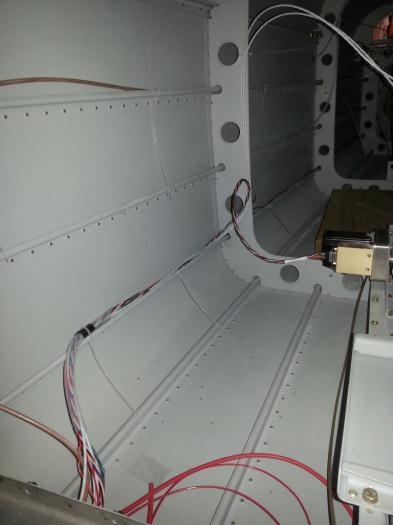

Now that the wiring has been fully run through from the rear of the aircraft to the front, it was time to lock down the baggage area and begin securing the wire runs down the tail.
I have elected to mount the wiring along the stringers. A small hole at thirds along the stringers staying away from the rivets mounting the stringers to the skin.
I have read a number of suggestions on wire runs to the tail and this seemed like the best option for clean and simple wire management.
As always it is a little more complex than just running the wire and some sleeves were required to be mounted between the bulkheads and stringers so that the wire would not rub against the bulkhead when travelling down the stringers.

Securing the wire runs along the stringers
