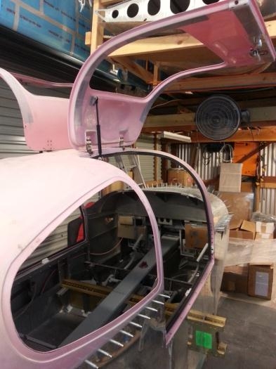

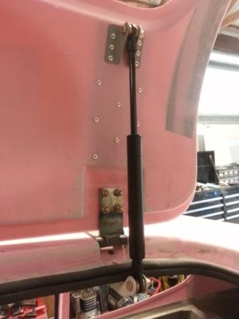

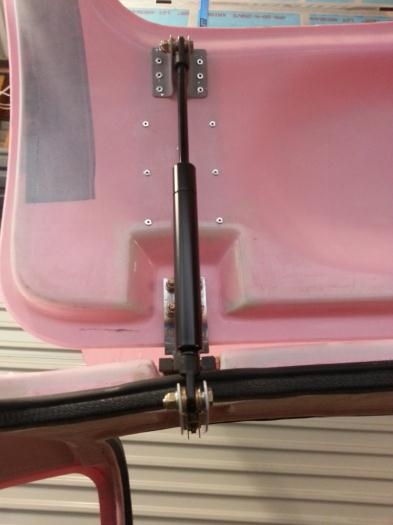

Brief Description:  Door Struts
This took a little effort to get right and taking accoount of the McMaster seals, the bracket needed to be set a little lower. This was accomplished by putting in place a aluminium spacer setting the bracket of the canope about 3mm.
Looks fantastic and the doors are even.I had to adjust the brackets slightly as the brackets were closer to the outside due to placement of the bracket. I should have adjusted slightly. We are only talking about at most 5mm.
