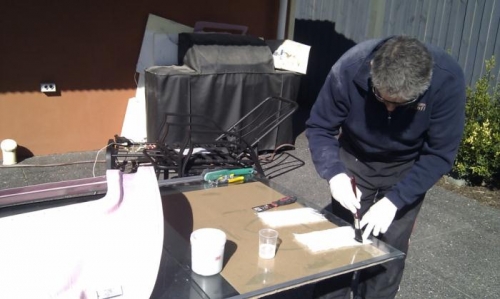

Today Dad and I worked on getting the two door halves together on the left door to start with. It uses the epoxy that I purchased and also this type of fiberglass called paraben. It is really cool and basically a 3D glass weave.
I used a glass panel to help wet up the glass, (just like I did with the overhead consol construction) and this worked well.
I had to mix two distinctly different epoxy mixtures. One was a straight epoxy to basically "wet" the surfaces and the paraben, the other a thickened mixture of milled glass and aerosil (Cabosil by diferent manufacturer).
Due to the amount of work required to be completed I needed to proceed very quickly so the epoxy did not go off.

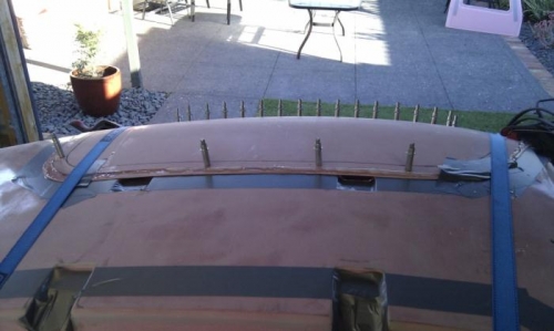

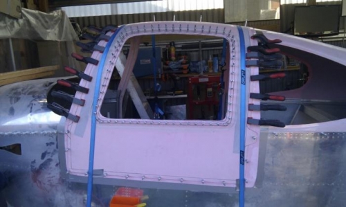

I completed one of the doors and pinned it all together with clamps and even luggage straps. Even after all of this, I still had some areas of the skins that we not quite mate correctly and need to be adjusted.
Wetting up the paraben
All stuck down....
All stuck down....
Some cleco's in the top
