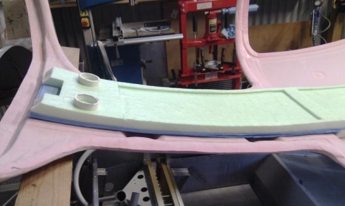

Brief Description:  Overhead Consol
Went to Clark Rubber today and selected some foams for use in constructing an Overhead consol. The existing offerings from the US are basically just too expensive to warrant the cost... Approx $1,300 to get it here.
So far I have purchased 10msqr 200gsm cloth, 5ltrs Micro Ballons, 6ltrs Marine Grade Epoxy, 2 ltrs Cabosil, and 2 ltrs Milled Fibers, all costing ~$250. It may take some time, however, I think the result will be worth it.
I modelled the overhead consol very much on the one from Aerosport, albeit some adjustments, and once all skinned and sanded in Microballons, the result should be quite good.
Full lenght shot
Full lenght shot

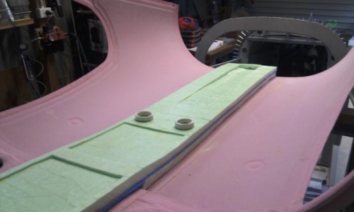

Front section
Front section

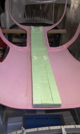

Rear section
Rear section
