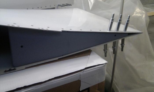

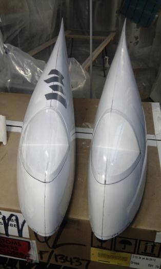

Today Dad and I completed the wingtip lenses. They fit really well....except.....for the right wingtip where the lense thickness was all over the place.
The top leading edge of the right wing lense was 'double' the thickness of the other side. This has caused quite a fitting problem between the edges and the fiberglass inset.
I have a good 1-2mm edge distance overstatement to the fiberglass.
I will check with Vans and see what they suggest, however, the part really should be uniform to ensure correct fitment.
Lenses on..
Lenses on..
Trailing edge almost set
