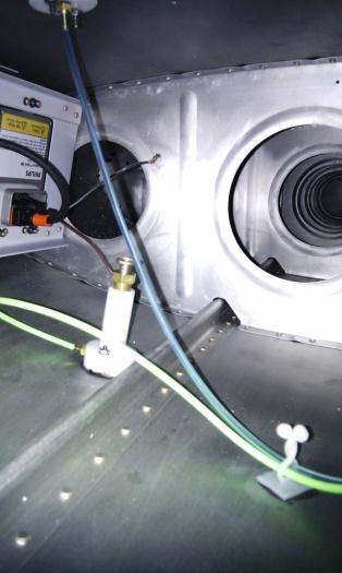

The AOA from AFS was a little finicky to install and in the end it turned out quite well.
I did drill the drain hole a little to aft of the perfect position by 1/8".
Therefore the correct installation positions for the RV-10 from my installation (taking account of the correct drain hole position) is as follows:
-- Wing span location --
Middle of the outboard wing bay. Upper port 9 1/4" and lower port 7 1/4" inboard of the wing skin outer end.
-- Wing chord location --
9" forward of the wing skin break at the spar

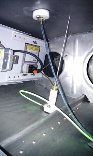

-- Drain hole location --
7 5/8" forward of the wing skin break at the spar (min was at 7 1/2" to far aft by 1/8")
9 1/4" inboard of the wing skin outer end.
Installed the components with Tank Sealant.
NOTE: Wing Span and Wing cord loacations on the AFS web site, unfortunately no drain hole loation.
Top in with a cable tie for tubes
Drain holee installed
