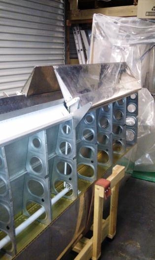

This was the remainder of the day; aileron fitment.

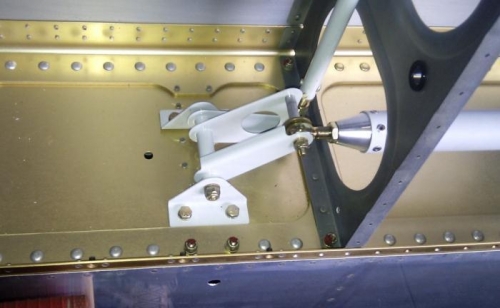

I have mounted them and completed all of the measurements to ensure they are mm perfect.
I have one issue, which did show its head earlier.... The left bell crank is not rotating correctly around the bushing.
When I looked at the bell crank earlier there was some weld from the arms that was still present in the bell crank. I will need to uninstall it and run some emery paper thorugh it to smooth it out and ensure easy and clean runing.
Bell Crank
Bell Crank

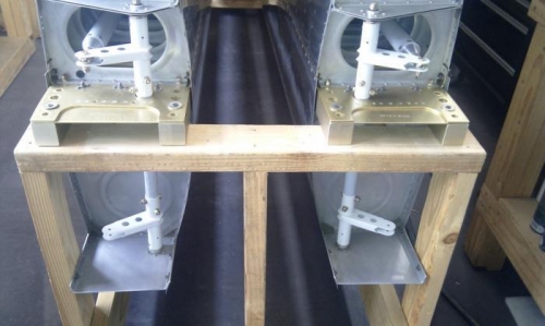

Aileron control rods
Ailerons On....
Ailerons On....
