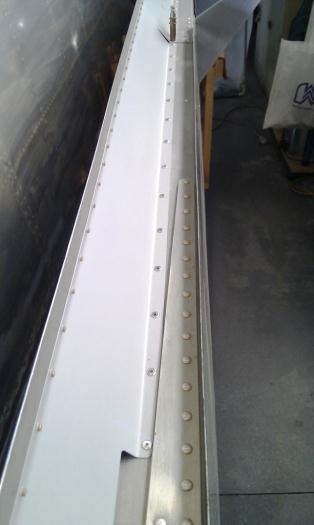

Today I got onto the riveting of the W-1021-L/R flap seals and noticed that I could not get anywhere near the ones theat were in the closed up section.
But with the 'good ol web' was able to find some info to help me.

Van's,
I'm attempting to rivet the W-1021-L/R flap gap seals on my RV-10 QB wing. It appears I'll have significant difficulty reaching in to buck (and inspect) the inboard 5 or 6 AN470AD4-4 rivets because the bottom wing skin is already riveted in place. Is it acceptable to use LP4-3
rivets in this location?
Thanks,
Tim Lewis

----- REPLY ---------
From: "Bruce Reynolds"
To: Tim_Lewis@msm.umr.edu
Date sent: Mon, 6 Dec 2004 14:39:22 -0000
Subject: Re: RV-10 QB Wing difficult-to-reach rivets
for W-1021-L/R
Priority: normal
Tim,
You guessed right, use LP4-3 blind rivets on the gap seal.
Bruce Reynolds
brucer@vansaircraft.com
Should be in the plans though..... :-)

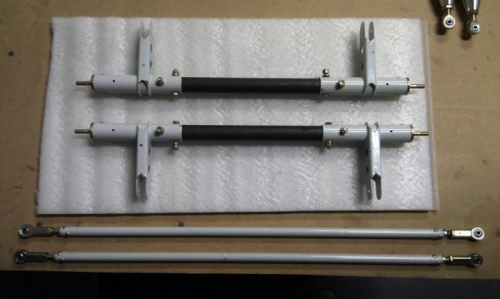

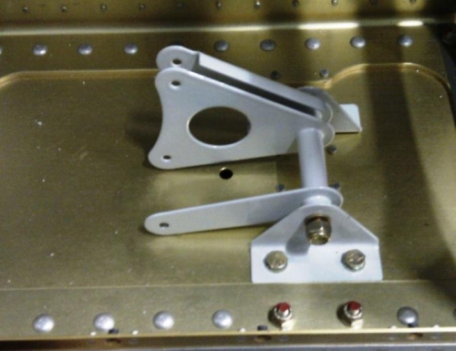

Also completed the control rods and the aileron actuator controls that are fixed to the wing root.
Pop rivets for the elevator fairing
Control Rods
Control Rods
Bell Cranks complete
