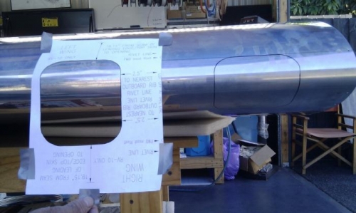

Today Dad drpped around and we completed the trailing wing flap supports by completing the drilling, deburring and dimpling. That was the morning gone....
Now it was onto the preparation for the Duckworks lighting. This took a lot of careful thinking and I must admit, I was nervous cutting into a good wing, however, everyone else does it........
I made sure I had all of the required equipment.Cutting wheels, grinders etc..

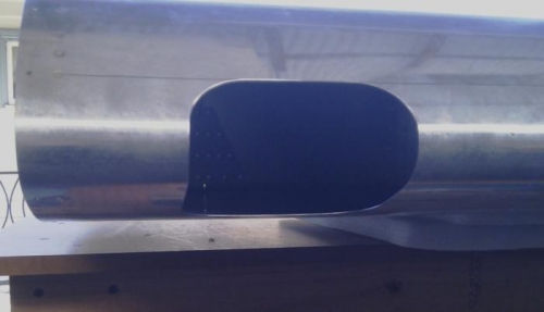

The template was excellent. Made the process of marking and cutting the lines very straight forward. I made some significant quality cuts and then used a dremel 'gouger' to clean up to the lines. After that finished with a little file and some scotchbrite. Excellent. I am very happy with the results.
I would say half of the time spent today was cross checking everything that was done and then re-checking.... Glad it is over. On to tomorrow.
Nice template
Nice template
Whew! That took courage :-)
Nice and clean
Nice and clean
