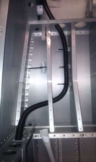

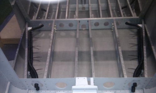

Brief Description:  Completed conduit
Finished off the conduit for the electrical cabling. I constructed two mounting brackets for the conduits as they run out into the tailcone.
Also given that the base wire runs already allowed for at the base of the side fof the fuselage, I included only a small section to help contain the slump in the wiring as it moves through under the seats.
Also given the grommeting of the holes in this section, there was no real place for attachment. Given this fact and the wires will need support and not much elase I decided to go minimalist. Especially should they ever need replacing, a draw through of old wiring will have little resistance.
Nice and even.
Nice and even.

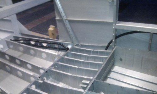

Slump connector
Slump connector
Ready for panels.
Ready for panels.
