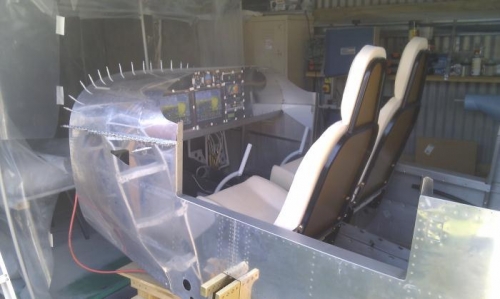

Well I decided as I have not got a lot to do just at the moment while I decide on what new bits I want to add, I would test fit the seats and see what it all looked like. :-)
It looks great!!!!!!
i also have completed some printouts of the avionics that I want to incorporate into the build. You can see a rough layout on the 1st picture.

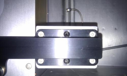

What is interesting with the test fit of the seats however was the realisation that the Mounting brackets for the seats needed to be 'adjusted' and that they needed to have the drill holes modified to bring them into alignment. I unfortunately adjusted the wrong way and now one set is not up to my build standards and need to be re-done.
Next large order to Vans I will include them.
Test fit, looks good
Need some support adjustment
Front and rear are OK.
