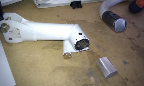

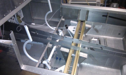

Brief Description:  Re-drilling Control Column and fit
Over the course of the last couple of weeks I have had the control column tubes welded up and made ready for re-drilling. This was due to identifying that the drill holes were un-even and not well supported.
I also created some aluminium inserts to act as support compression blocks. This worked well and I am very happy with the final result.
Aluminium Inserts
Aluminium Inserts
Control Arms Fitted
Control Arms Fitted
