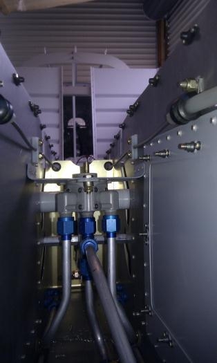

Brief Description:  Andair Fuel Selector installation

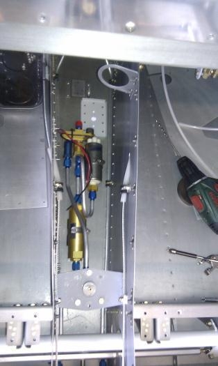

Today Dad and I completed the installation of the Andair fuel valve. Only the lower section and its pipe fitting were completed, however, it is a start.
I am awaiting the extension from Andair in the UK. Having some problems getting any information from them as to validating the payment and an expected postal date. Hopefully I will get something in the next couple of days.
I expect that once I get the extension I will be able to construct an upper bracket and mount the full valve selector. I am going to construct the upper bracket so that I can cut a whole in the upper panel. This will allow future maintenance to be easier as I will not need to take off the selector valve tap.
Fuel Valve connections
New Install Plate
New Install Plate
