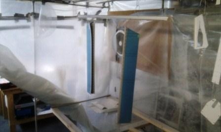

Some parts primed
Some parts primed

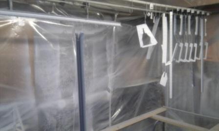

Trim tabs...
Trim tabs...

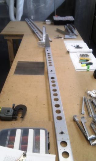

Prep for riveting
Prep for riveting
